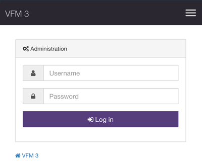

Navigate with your browser to the url where you uploaded the files, if it's your first run the script should redirect you to the /vfm-admin/ login
Inside the administration area, go under USERS and update your Master Admin credentials (password and username).

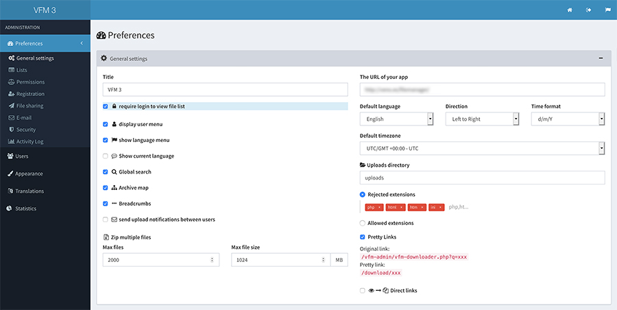

To best fit your needs you have an administration panel where you can choose many options

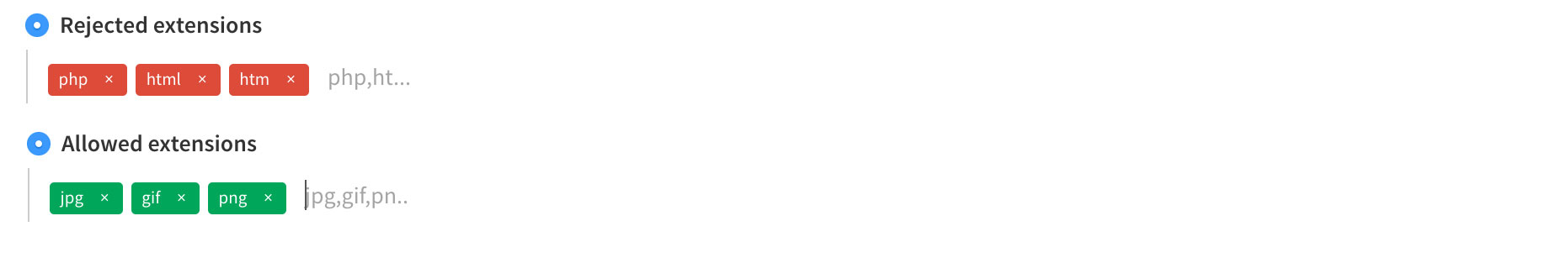

From general settings you can choose if to exclude some file extensions, or if you prefer, to only allow some extensions (and exclude all the others).
If you activate Pretty links, the script will convert download urls from /vfm-admin/vfm-downloader.php?q=xxx
to /download/xxx.
This option needs the .htaccess provided in the main directory of the script, and the Apache Module mod_rewrite on your server.

In order to prevent timeouts and server errors during the zip process, the script is limited to .zip files up to 1 GB, and 2000 items max together;
if the values are exceeded, it asks you to download less files.
You can adjust these values if your server is more or less performant, changing Max Files and Max File Size under general settings

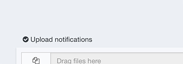

If the option Send upload notifications to other users is active, any user with an e-mail address associated will be able to select the other users who can access to the current directory and send them automatic upload notifications

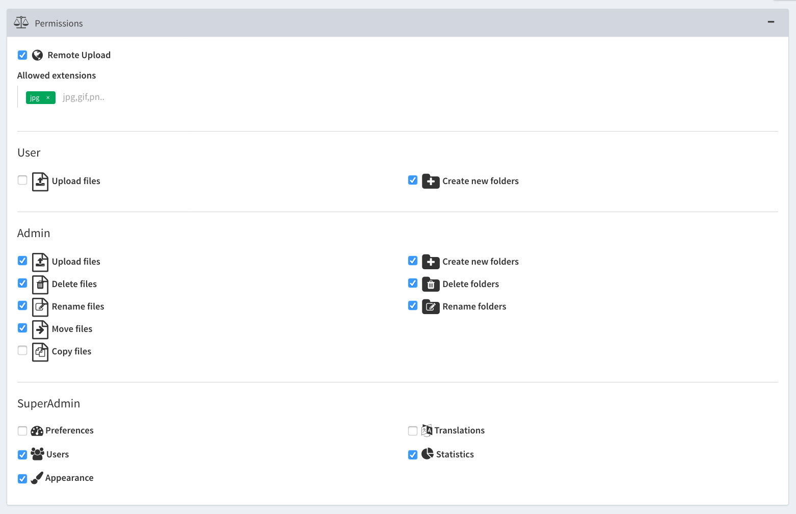

If the option Remote upload (under permissions) is active, you will be able to upload files directly from remote urls.
NOTE: the remote uploader is subject to the server upload limits, so if you want to upload big files you should possibly increase the following values via htaccess:

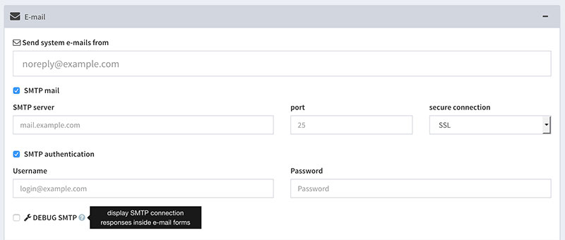

File sharing, New user notification and Password Recovering use PHPmailer, with the possibility to choose between the php mail() funcion (default), or SMTP mail.
Using the same server of your installation as primary email is strongly recommended, to avoid being flagged as spam.
(e.g: if the script is running on www.example.com, the mail sender should be something like noreply@example.com, or info@example.com)
NOTE: If you haven't set SMTP mail and the script says "message sent", but you don't receive any e-mail, probabily your server refuses to send mail() in HTML format, so setting up a SMTP account should solve the problem.
SMTP connection errors can be tracked setting DEBUG SMTP ON

Since version 3.3 the role "User" has 2 optional permissions: Upload Files and Create New Folders.
Since version 2.9.2 can be enabled the remote uploader, and will be available to all the users with upload permissions

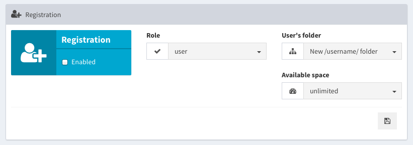

You can choose which role to assign to all new registrations, which folder and how many space.
(the option New /username/ folder) creates a new folder for each registration, using the username)
To enable the self user Registration the send system e-mails from field must be compiled

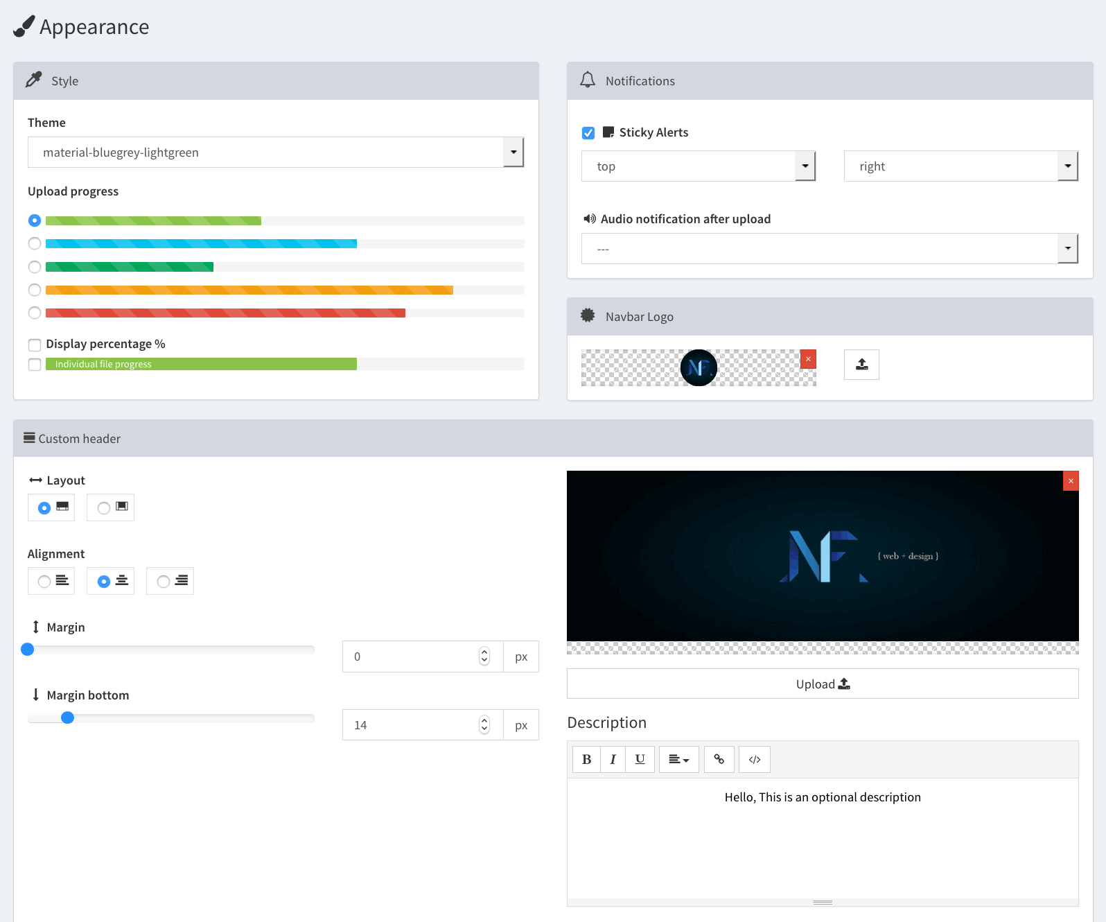

The panel Appearance includes a Skin selector, a customizer, and the options for the notification alerts
Choose between 26 skins and 5 progress bar variants
All skins are stored inside/vfm-admin/_content/skins/
To create your custom skin duplicate one of the existing, rename it and edit the new css file, then activate your new skin from the Administration panel.

You can add your custom Audio notification after upload simply placing a new .mp3 file
inside the folder /vfm-admin/_content/audio/, it will be a new voice under the dropdown menu (Appearance > Notifications)

If you can't do the first login, probabily the script hasn't enough permissions to write on config.php and /users/, consult this F.A.Q.

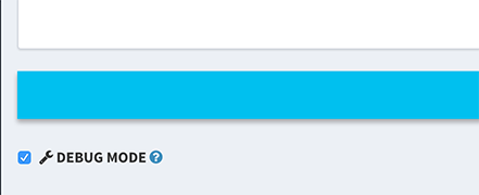

For any other issue, as first check, turn ON all php notices:
At the bottom of the main administration page you will find the option DEBUG MODE
This option will display all PHP errors and notices (if any).

If you can't bypass this limit, you can activate the option Direct links under General Settings, so downloads won't be processed via php.
